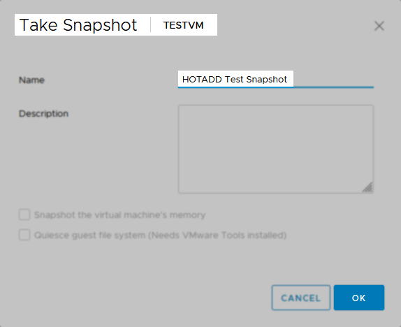

  1. Create a snapshot on the VM to be processed by Veeam Backup & Replication.

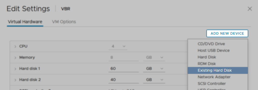

    1. Edit the Veeam Proxy that will be processing the VM from Step 1.
    2. Click [ Add New Device ]
    3. Chose “Existing Hard Disk”

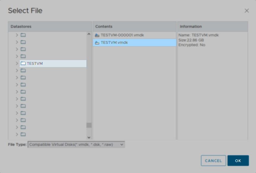

    4. Navigate to the location of the base disk from the VM in step 1.
    5. After selecting the disk, expand the disk node.

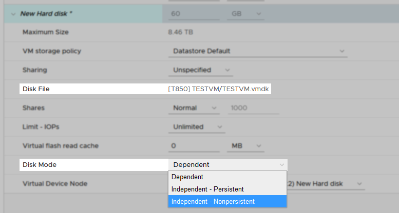

    6. Under "Disk Mode" select to "Independent - Nonpersistent"
    7. Click [ Ok ]

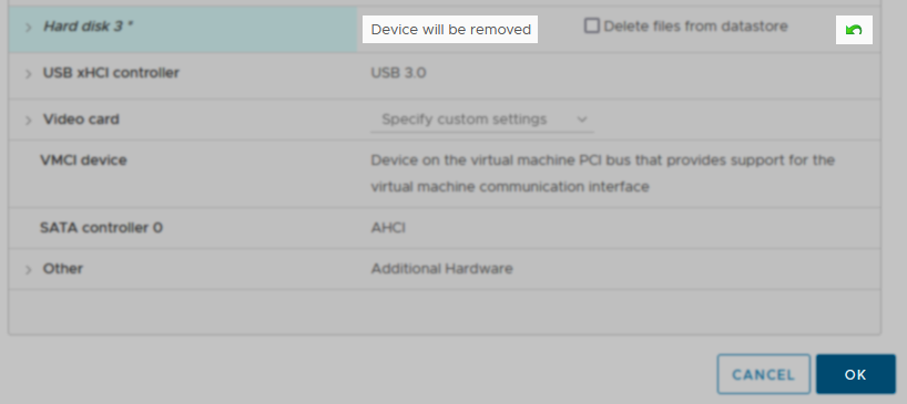

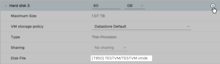

  1. If you were able to attach the VM's disk to the Proxy, detach it.
    1. Edit the Veeam Proxy used in the testing.
    2. Hover over the disk that was attached during testing.
      Note: If you are unsure which disk needs to be detached from the Proxy, check the disk's file path, it should contain the name of the production server from which it is from.
    3. Click the ( X ), which will turn into a green arrow indicating that the disk will be released.
      (DO NOT select the option to "Delete files from datastore")
    4. Click [ Ok ] to release the disk(s) from the Proxy.
Identify the hotadd test disk(s) and remove from Proxy
Steps 1b and 1c: Identify the hotadd test disk(s) and remove from Proxy.
Double-check which disks are being removed, and click OK.
Step 1d: Double-check which disks are being removed, and click OK.

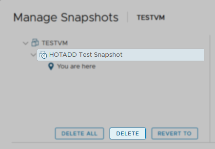

  1. Remove the snapshot created on the production server during testing.
 Remove the snapshot from the VM that was being tested.
Step 2: Remove the snapshot from the VM that was being tested.
